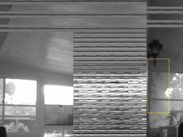

I am still getting the glitch with a D-Link DCS-933L. I've added a flag to the cgi as recommended:
Did i specify the query incorrectly?
Re: Camera picture Glitches
by ryan » Thu Jun 26, 2014 9:08 pm
@303 - that would be correct. If it isn't working the problem probably isn't coming from dropped packets, the camera is either generating incomplete or broken frames occasionally, or at least incompatible. How often do you see these? daily/hourly/etc...

ryan wrote:@303 - that would be correct. If it isn't working the problem probably isn't coming from dropped packets, the camera is either generating incomplete or broken frames occasionally, or at least incompatible. How often do you see these? daily/hourly/etc...
About once an hour in what seems to be night mode only
by ryan » Wed Jul 02, 2014 3:43 pm
Thanks 303. Does it look like the attached image? Someone on our team picked one up and experiences periodic frames like this at night. The way things in this image are shifted around it appears that the camera is simply generating a bad frame. I found several reviews on this and a few other Dlink models that report glitches in other security software as well as simpler viewers like VLC.

303
by 303 » Wed Jul 02, 2014 6:52 pm
That's exactly it. Any suggestions?

@303, can you tell whether this happens when a bright light occurs? The manual mentions the image sensor overloading in bright light scenarios, though it doesn't detail all the symptoms.
This camera does support simultaneous MJPEG and H.264 streams. If the glitch you're seeing is the result of an encoder problem using the other stream may not exhibit the problem, though with some tradeoffs - H.264 will use slightly more CPU on your system to decode the video, MJPEG will use more network bandwidth.

ryan wrote:@303, can you tell whether this happens when a bright light occurs? The manual mentions the image sensor overloading in bright light scenarios, though it doesn't detail all the symptoms.
No bright light, just the occasional spider or moth
