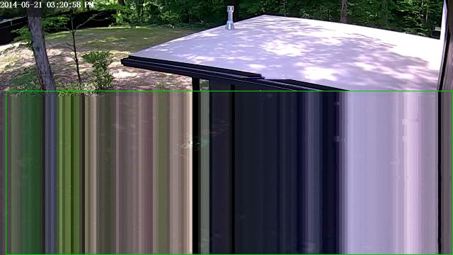

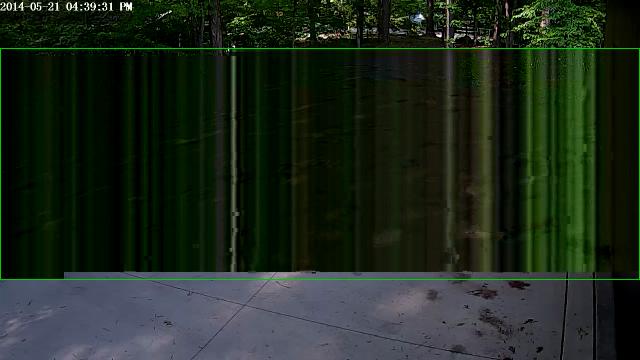

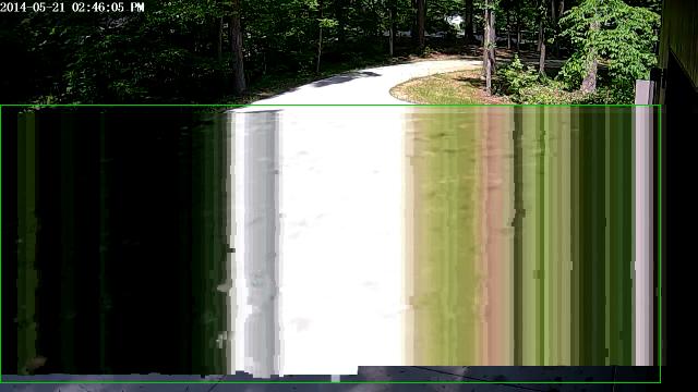

I have been having the exact same problem as Sammi showed, since I started using Sighthound with my Foscam FI9805E cameras (I have four of them). When viewing the feeds in the browser plugin that Foscam provides, the 720p RTSP streams look perfectly clear. But when Sighthound is viewing the feeds, they display a lot of artifacting where it seems like the pixels get smeared up or down parts of or the entire view. It is sporadic, throughout the day I might get them 5-10 times (but of course, each time it sends me an alert). Sometimes I feel like it's more likely to happen in times where there's a lot of contrast (like when the sunshine is bright in the view), but not sure. I've tried resetting all of the cameras but that doesn't usually make a difference, nor does reseting my router or switches. I've attached a few examples of the screens I get.
I have a feeling that Foscam uses a slightly unique way of encoding/decoding RTSP streams, as I think LiveCams Pro (the iOS app I use to view my streams) was aware of the same issue and was able to address it with help in working with Foscam on it. Ideally it'd be great if we could figure that out, but if not, perhaps some feature in Sighthound where it knows to ignore conditions like this somehow? I have set the length of time an object is detected to 2-3 seconds in an attempt to minimize the alerts but I still get them frequently.
Any thoughts? Anyone else with Foscam cameras that see this same effect?
