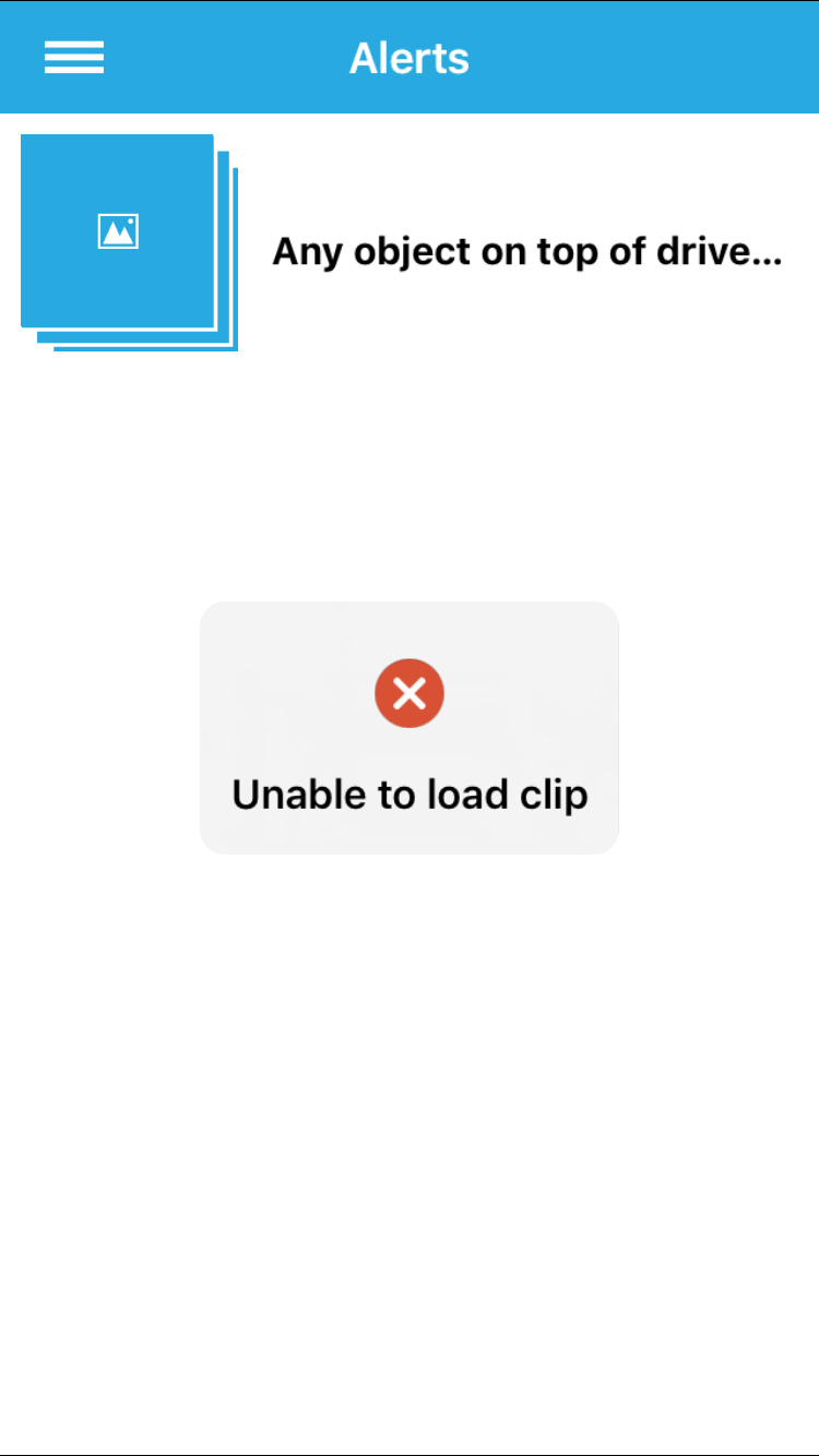

Logs submitted again...problem occurred again at 8:20p...received mobile alert and "Run a command" was run, but there is no corresponding clip saved.
Also, something I meant to mention earlier...when I receive one of these false mobile app notifications, the clip is unable to be viewed, which corresponds with the fact that the clip is not saved. Please see attached screenshots...

by teladog01 » Wed Nov 16, 2016 9:26 am
Logs submitted once again...
Received mobile notification and "Run a command" was run at the following times:
11/15 10:12p, 10:24p, 10:30p, 10:45p, 11:15p, 11:37p, 11:47p, 11:53p, 11:58p
11/16 12:32a, 12:42a, 1:01a, 1:03a, 1:19a, 2:35a
There are NO clips saved that correspond to any of these notifications.
Also, just before submitting this report this morning, the program crashed, with a message like "The program has encountered a program and must exit" (not sure if that was the exact wording). This happened when I changed the "When" field from Yesterday to Today in order to see any clips that were saved overnight. This is the first time I have noticed the program crash like that.
