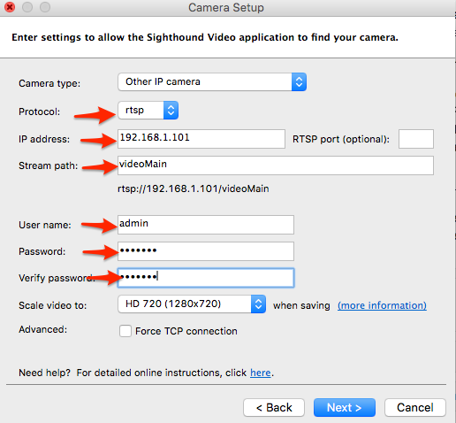

by liqmetal » Mon Dec 14, 2015 8:48 pm
C1 Camera Setup
(54.47 KiB) Downloaded 961 times

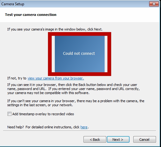

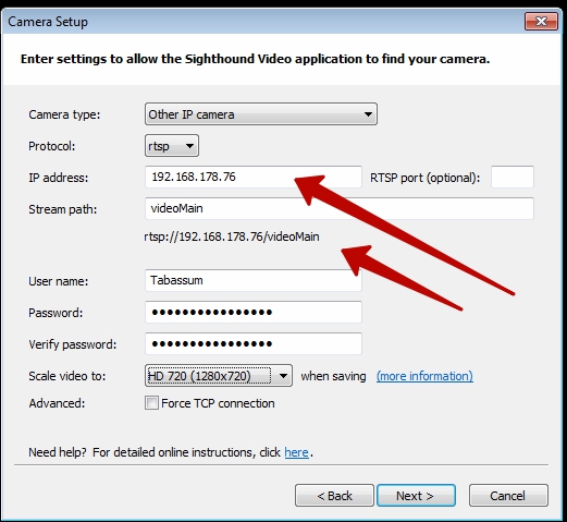

@ liqmetal,
I have done exactly the way you showed in the screenshots
For reference I have attached my screenshots. It is simply not working at my side :?
System Firmware Version 1.9.3.15
Application Firmware Version 2.52.2.16
Plug-In Version 3.3.0.7
Do your cameras have the same versions as mine?
Thanks for your help.
