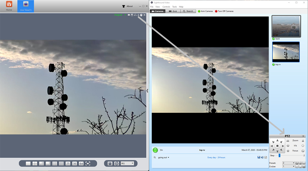

by CV SECURE » Sat Mar 07, 2020 8:10 pm
(PTZ) camera controller with sitehound video how To.
in windows 10 they call it split screen / snap to/ multitasking.
any ptz app should work. i use a app by sunba which all so has a floating PTZ(controller)
i moved the controller under sitehound video (Bottom Right), it works in real time.
click image.

What PTZ controller software are you using?
I just log into the camera's web address using a browser and control the camera that way. I shrink the browser window or drag the majority of the window off screen to show just the control buttons so it does not take up much screen real estate, but it still clogs the network with a second video stream for every instance of a control window since the browser is also displaying the video from the camera (even if it is unseen on the screen).
Of course, changing the camera view can cause motion detected in SH, but since I know I am doing the pan/tilt/zoom I know to ignore the alerts at that moment.
