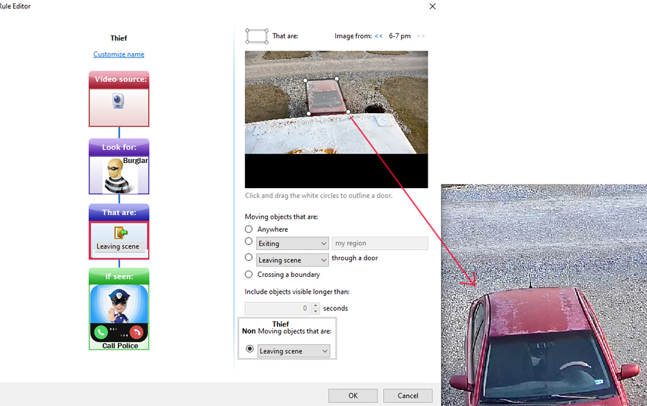

Rule Editor Thief on Non Moving objects.
if a NON Moving object is not in the scene anymore
it will set off the Alarm Trigger that the object is not there anymore.
meaning if My car was there and now its gone it got stolen.
click image below.

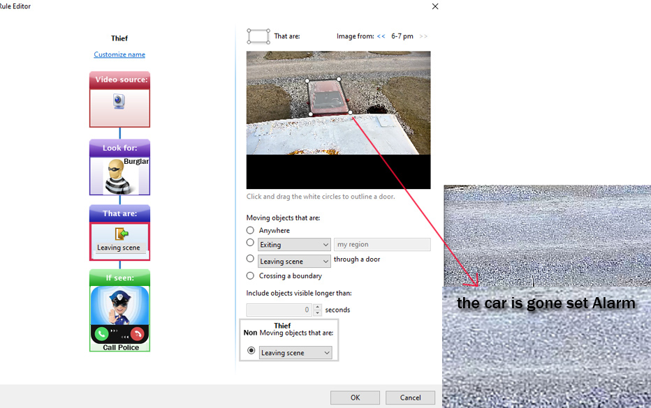

image below the car is Gone, now set Alarm to Trigger alert

The image that you are seeing in the rule editor is just one of the first images that Sighthound Video has collected. It doesn't reflect anything about what that camera is seeing currently and will not affect future detections. We use it as a base that you can use to determine how you would like the rule set up.
Does that make sense? Please let us know if you have any other questions or concerns, thank you!
-Kevin

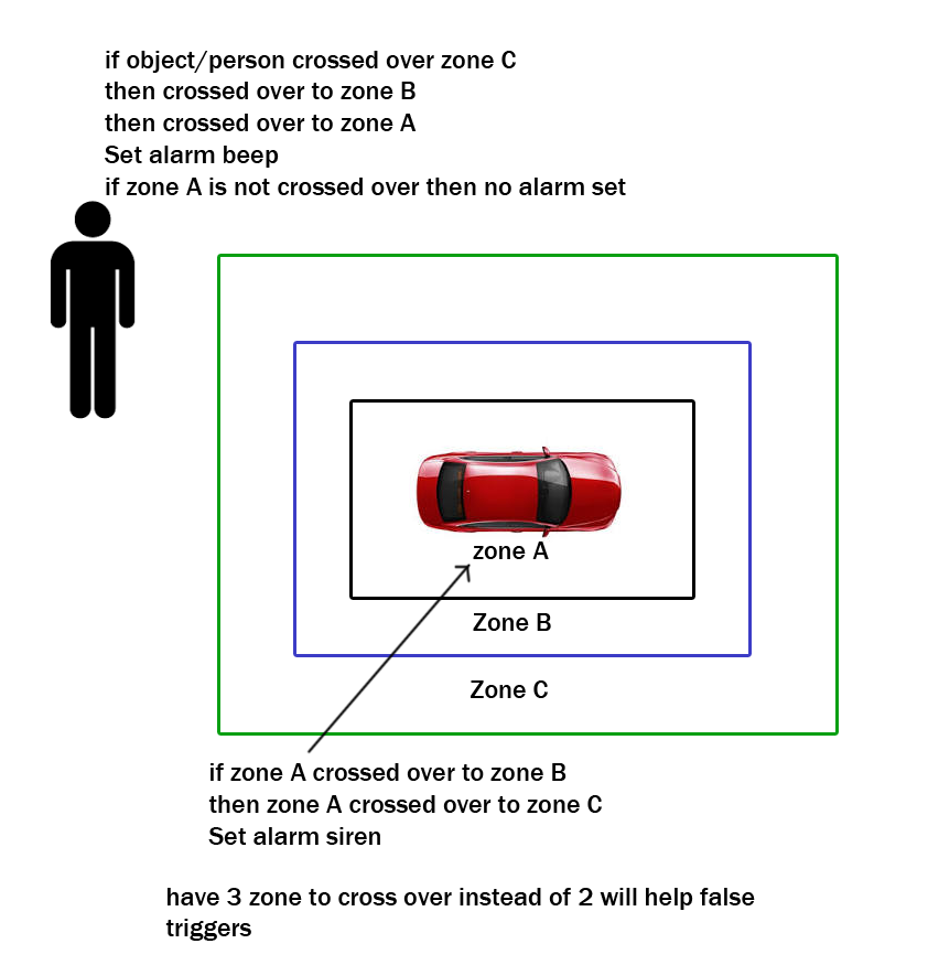

click image below this is kind of a idea.

Thank you for your feedback. I understand where you are getting at. This would need a complete backend re-code since the Sighthound Video actually uses other methods to detect objects that wouldn't work with this. However, if the car moves even after being parked for hours, Sighthound Video will immediately detect that motion. What you can do is have your rules looking for a vehicle and have it in a bounding box that if it ever leaves you get an alert. That would be the closest to what you are looking for.
Another reason why this wouldn't work is because of the work it would have to do to detect and classify objects every frame. Sighthound Video only detects and classifies objects when there is movement. So when there is no movement CPU load is a lot lower. Doing something like this would really overload the CPU.
Finally, as you said, you will need to detect these people far earlier than when the car is leaving. What you can do for that, is to detect people when they are in proximity to your car. You can put a bounding box around the driver's side of the car looking for people. If a person gets detected, that means they are near that door and it should be investigated (dogs let out) anyway.
Does that make sense? You should be able to manipulate the rules in a fashion where you can detect certain movements with certain objects at all times. If you want some help with that, we are always here to lend a hand with anything. Please let us know if you have any other questions or concerns about this, thank you!

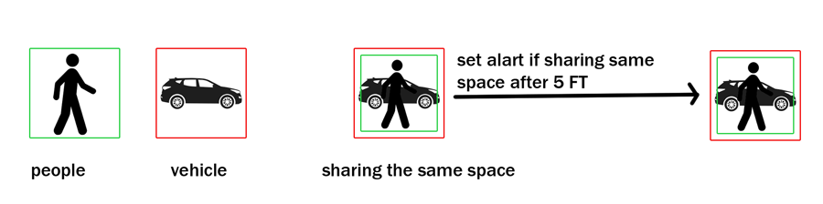

See image below you would need to set the rule name looking for people and a rule name for the vehicle,because if you dont a person and a dog walking together could set off the trigger because they share the same space
the app will only trigger if 2 items share the same space, that will give you less false alerts,
all so i put a distance of 5 ft to trigger a alert if they share the same space
the reason why is to tell the app hes just not walking by the car, there both moving together like he maybe steeling it.
