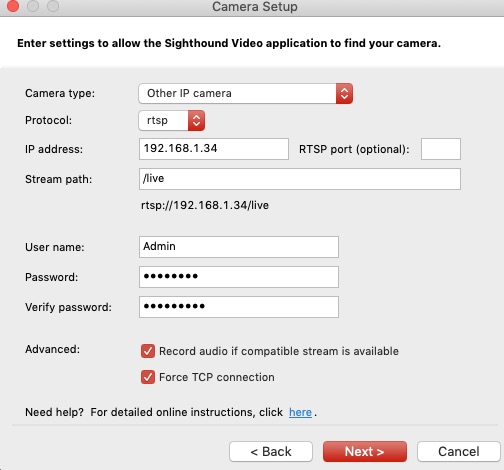

Here's how to get it setup:
Screenshot below. You do have to have the Special RTSP firmware setup on your Wyze Camera per Wyze cam instructions.
Just fill in your Ip, Username and password, like below and it will pop up.

Thank-you Thank-you Thank-you. Stupidly I had port set to 80 and did not notice.
