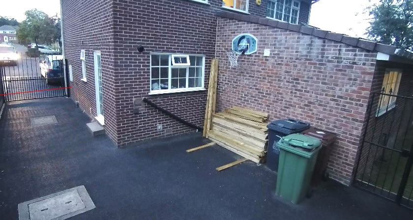

I've got an outdoor camera and I want to detect if someone comes through the gate onto my driveway. I've tried various methods including crossing boundary, entering a region, through a door etc but it's not picking up the tests I've been doing.
I've attached an image showing a crossing boundary rule.
Any tips on best use of a region to detect the entry through the large gate?
Thanks

by Semper Vaporo » Sun Aug 12, 2018 12:39 pm
Try raising the line higher. Also try tipping the line at an angle (in your situation, low on the left, high on the right). I believe the "Crossing a Line" detection requires the center of the detected moving person/object to cross the line. With the line low, only a very short detection box would have the center cross the line. A tall detection rectangle would have to come deep into the driveway before the center would cross a low line.
It can take some mind bending to think in terms of a flat scene... the software does not know about depth in the scene. You have to take that into account when selecting the detection method.
"Entering or Exiting a door" also requires an opaque door, so the moving person/object will just appear in the scene, rather than come in from the side. If the movement is seen through the door/gate, it cannot just "suddenly appear".
