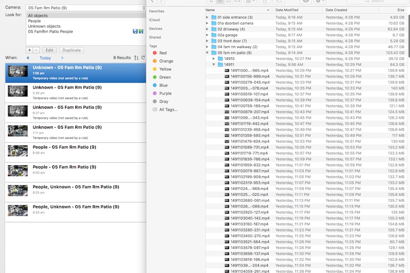

Yesterday I re-cloned my SSD, intentionally deleting my Sighthound stored videos. I was surprised to find that my folder rapidly repopulated itself. In looking at the folder, I have a continuous stream of movies each about 120+ mb in size. These are not listed by Sighthound in the "camera: Look for: all objects" menu. I attach a screenshot. Why would SH start continuously recording, and even if it is doing that, not list the recordings in the "camera: lookfor: allobjects" menu? This is a huge amount of activity and is not friendly to my SSD.

"ALL" video is continuously recorded. ALL OF IT! It is broken into 2 minute segments and those are the file names you see in the folder.
When the space allotted for the video is full, then the oldest videos/files are deleted to make room for new videos/files. With one exception...
There is a "database" that contains pointers to the beginning and end of any of the video that matches a rule you have set. When the space is used up, the files are split up to create just one contiguous video of that event from beginning to end and the left-overs on the ends are deleted, so that small segment remains for later review by the user and space is freed for new video.
There is one other consideration... you get to set how long to keep video that does not match a rule. You can set it to as little as 1 hour or longer as you wish. Of course if you set it to a large enough value then the "space limitation" takes precedence. If the time limit is reached then the same process is used to split up the raw video files to produce the rule based segment. Note that it does not seem to delete the raw video immediately after the time limit is reached, but does it as needed; so there might be files older than the time limit you specify, but there is no guarantee it will be there longer than what you specify.
At some point, even the rule saved segments will need to be deleted, but at least they will be the oldest and you have some number of days/weeks/? to review the video and save it elsewhere if you wish to keep it longer.
But the gist of it is that the folders will fill up with 2 minute segments of raw video until the allotted space is filled or the time limit is exceeded.
Unless you are prepared for the problems it can cause, it is recommended that you do not mess with the raw files themselves. SightHound does do a good job of recovering from humans messing with the content of the raw video folders (I am one of those nerds that can't keep my hands off the raw data and I have seen SightHound handle my meddlin' gracefully), but there really is no need for us non-computers to even look at the folders... SightHound will maintain the content.
