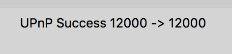

On iCamsource it always showed (see snippet below) the port forwarding to be 12000, so I assumed it would be that...
(19.02 KiB) Downloaded 207 times

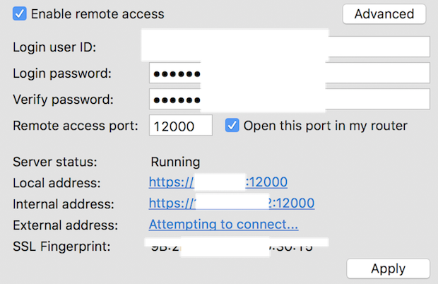

So I set-up the preferences in SH as follows:
(254.88 KiB) Downloaded 207 times
The local address and internal address both work, but no external address ever displays, and I don't know what the external address should be for the APP. Is it not the same as the internal address?!?

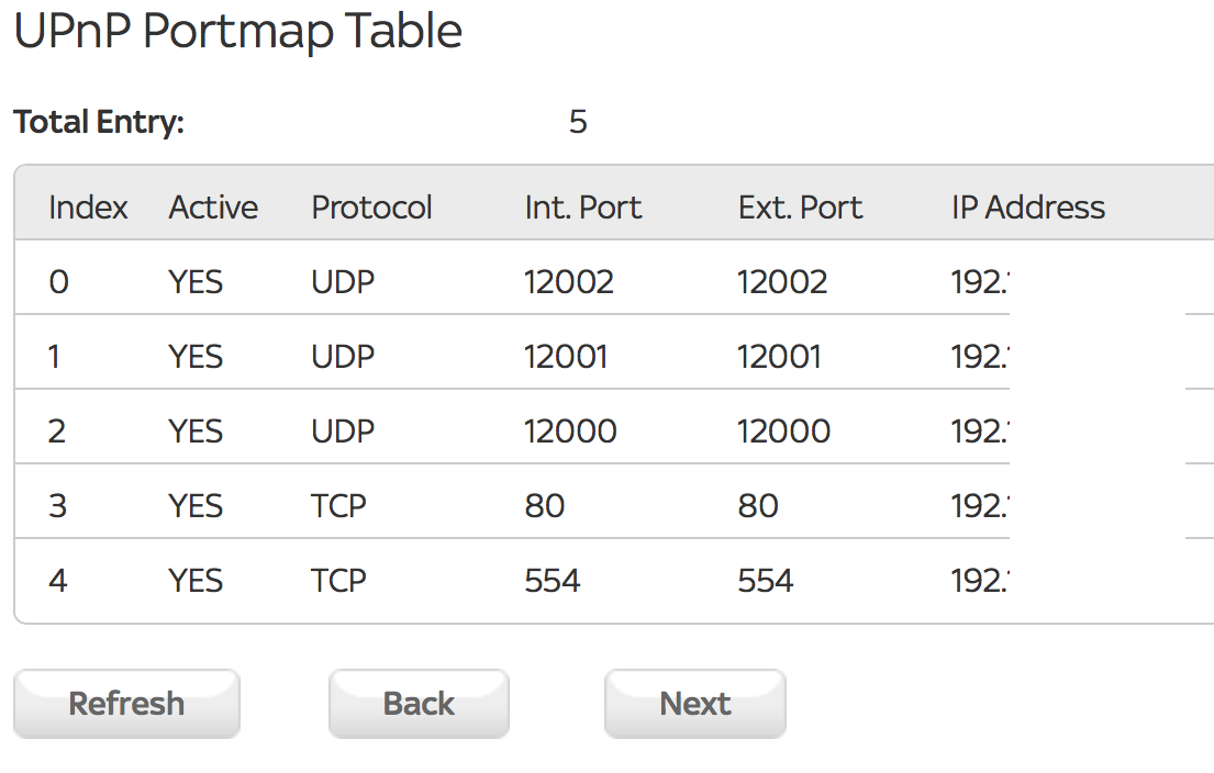

I've logged into my router and the UPnP port map table looks like this:
(84.39 KiB) Downloaded 207 times

The port number requested for remote access should be a number that is not being used by any other device or application. It looks like 12000 is already being used by your iCamsource, so you will want to select a different number. We typically recommend 8848, 9000, 9090, etc...
Are you able to connect to the Internal Address from a computer or mobile device that is on the same network as the computer running Sighthound Video? If yes, we should be able to forward a port in your router to connect remotely. Please send us the manufacturer and model number of your router and we'll send specific directions on how to do so.

Here's a port forward guide for your router. Please add a rule for remote access, similar to how you created the upnp portmap rule: http://www.skyuser.co.uk/forum/content/ ... vices.html
Note that the external address in the remote access settings page will not appear, even after successfully forwarding a port, as Sighthound was unable to open the port on it's own. Instead, you can find the external address by visiting whatsmyip.org from inside the network. You should then be able to connect from a computer or mobile device that is not connected to the network by entering the external address with the forwarded port number (external.ip.address:port). An easy way to test this external address is with a smart phone with WiFi disabled.
If you are using the mobile app it will remember the address, so you only need to enter it once.
