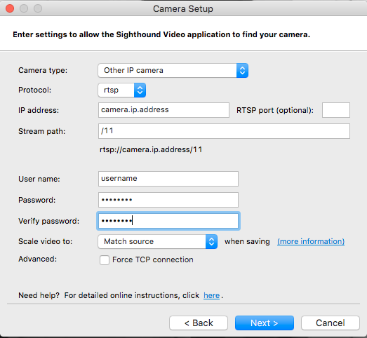

Both of those Foscam models should be able to connect using the "Foscam (other H264)" pre-configured setting and the Microseven model should connect using these settings:
Protocol: rtsp
Port: <leave empty>
Stream Path: /11
I've attached an image of how that url should look when manually entering it in to Sighthound Video.
