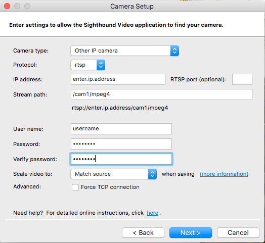

I have several of the AV20175DN Arecont cameras that I have been trying to hook up to the Pro version. It is a single cable/ four camera 360dg unit that shows all four cameras from the one cat 5 connection. I am able to get video but only for one of the four cameras. I use the arecont software page and see that all are working but only one that shows up on Sighthound. Any suggestions.

I did some research on these cameras and believe I've found the correct stream settings. In the camera setup, select "Other IP Camera" from the "Camera Type" drop list and use the following settings for each camera:
Protocol: rtsp
Port: <leave empty>
Stream Path: /cam1/mpeg4
I've attached an image of how this should look once entered. You will need to alter the stream path to point to each individual camera. The example I provided "/cam1/mpeg4" will point to the first camera, so for the second you will need to use "/cam2/mpeg4" and so on.
