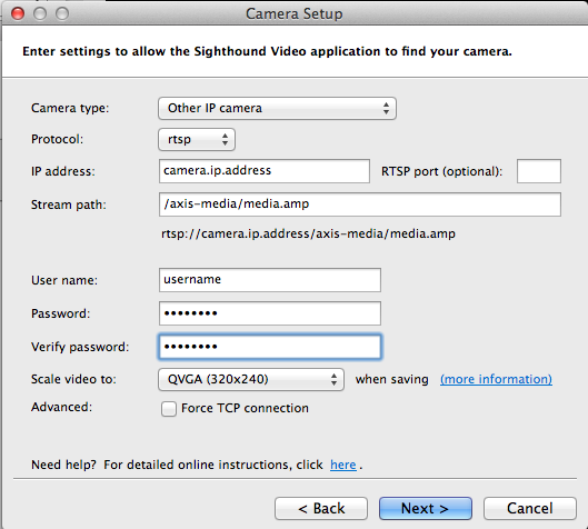

I'm sorry to hear you're having issues configuring these encoders. I checked with the Axis user manual and found the stream settings needed. In the camera setup please select "Other IP Camera" from the "Camera type" drop-list and use the following:
Protocol: rtsp
Port: <leave blank>
Stream Path: /axis-media/media.amp
I've attached an example of how this should look once entered. If you do not know the IP address of your encoder please see this article for directions on how to find it: https://www.sighthound.com/support/how- ... -my-camera
(56.03 KiB) Downloaded 354 times

I did some more searching and found that several other Axis encoders use the following at the end of the stream paths: "?camera=1", "?camera=2", etc...
Please try adding this to the end of the stream path for each camera as such: "/axis-media/media.amp?camera=X" and substitute X for the camera number. Additionally the manual indicates that you can configure your streams on the configuration web page for the encoder. These pages may contain the stream url information needed.
