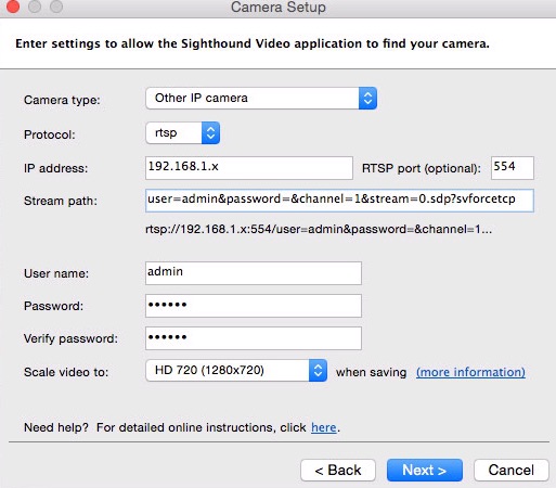

aaronwroblewski
Joined: Tue Feb 03, 2015 10:18 pm
Re: Sighthound not able to discover ONVIF cameras?
by aaronwroblewski » Tue Feb 03, 2015 10:37 pm
This is how I connect my ONVIF Cameras.
Try using this as your stream path, make sure you include your camera username and password.
user=myusername&password=mypassword&channel=1&stream=0.sdp?svforcetcp
See the attached image for more detail.
(67.61 KiB) Downloaded 498 times
