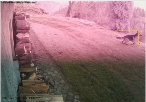

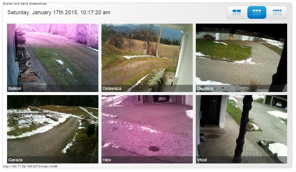

by zxcslo » Sun Jan 18, 2015 4:32 am
Few month ago one of the cameras started to show pink picture during the day (at night it black and white). Now few days ago second camera started to show pink. Can any body tell me why?
(159.8 KiB) Downloaded 240 times
All 6 cameras are 1.5 years old. All have the same settings. I tried reset them to factory settings, update to latest firmware, but nothing helps.
I'm using Sighthound software and I've been very satisfied with it.

by zxcslo » Sun Jan 18, 2015 11:40 am
The cameras are Digitus OptiMax Pro DN-16040 (all 6 of them).
They are mounted outdoor, but none of them are on direct sunlight or rain. They are all under some kind of 'protection'. There were no temperature extremes here in Slovenia this winter. Yesterday and today is about 10°C. In technical documentation for cameras temperature range is -20°C ~ +60°C. This are no low price cameras. They costed around 200€ each.
This is from today:
(127.96 KiB) Downloaded 233 times
More then half a picture is now pink. :-)

by zxcslo » Tue Jan 20, 2015 3:38 am
@Devin
The moment I start reading the article it hit me: IR-cut filter! Mechanical! ...
All this IP cameras (from 150€ forward) have mechanical IR-cut filter, which covers the camera lens, when daylight sensor switches to day. Hence the sound of mechanical 'click', which you can hear, when the sensor switches to day at the morning and to night at the evenings.
On my cameras, it seems that IR-cut filter is 'stuck' somewhere in the middle over the camera lens, that why only half of the picture is pink. On the other camera, filter is not moving at all over the lens, that why whole picture is pink.
The cameras are outdoor for about 1.5 year. I believe that moisture and cold have done something on these two cameras to the mechanism for the IR-cut filter. Maybe they are not sealed so well or... I'll look on these, when I came home. Maybe I can open the camera and see what's going on.
Again, thank you for pointing me in the right direction.
