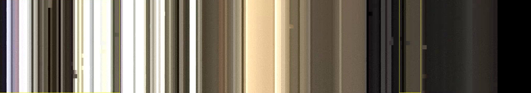

I have discovered that two of my (WiFi) cameras briefly "garble" a portion of the video image. I have attached a photo of a garbled section of the image. The problem is that this is triggering my Rules because it looks like motion (the suddenly garbled part of the screen looks "different" than the last video frame and I think that's part of how you detect motion). The problem is that this burst of garbled video is happening a very large number of times per hour. It seems to only last for a second but Sighthound keeps interpreting this as motion and firing a rule. I have disabled the default Rule that detects "Any Object" but my Search list is still full of "Unknown - <room name>" clips.

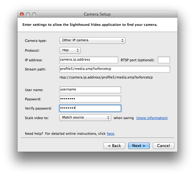

This looks like packet loss over UDP, an unreliable transport. Assuming that your camera supports TCP you can attempt to force a tcp connection by appending "svforcetcp" to the query string of the URL. As your url already has a query string, you would simply change it from "/streampath" to "/streampath?svforcetcp" If you could provide me with your specific camera model I can provide a screenshot of how this should be entered.
If this is due to WiFi network congestion you may need to reduce the resolution that your camera is streaming or, if you haven't already, connect the computer running Sighthound directly to the router.

When I read your suggestion I thought I knew how to implement it. I went to Tools | Edit Camera and stepped my way through to the Camera Setup panel where I supplied the ID, credentials and the "Stream path" which is "profile5/media.smp". But now I see that I am not explicitly entering a URL that contains "/streampath" so I don't know what to do (or where to do it). Please send the screenshot explaining this.

For the stream path you will want to enter "profile5/media.smp?svforcetcp". I've attached a screenshot as well.
