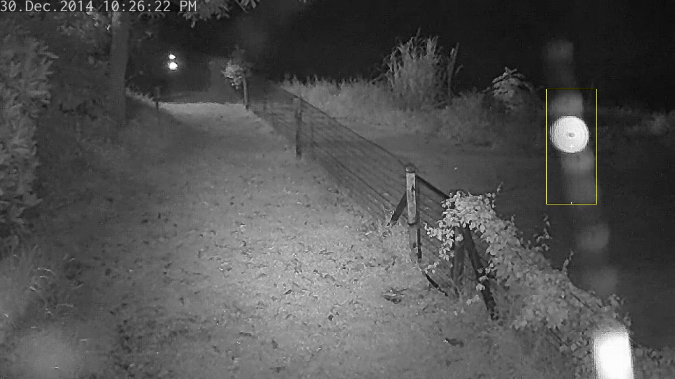

I get the same thing almost every night, some nights over 1000 false positives (as either person or unknown) per camera, when the spiderwebs blow in the wind.
I also think the only option is to get separate IR illumination.
This will also solve the false positives of the rain coming up as people.
Thanks for the tip on the WD40, will try.
I tried to upload a video, but it was 6Mb, then I compressed it to 1Mb, then got the next error that .mp4 files are not permitted?
Perhaps some tweaks to the uploader are needed?
Have attached a jpeg so you can see what it looks like.
Max
(183.82 KiB) Downloaded 321 times
