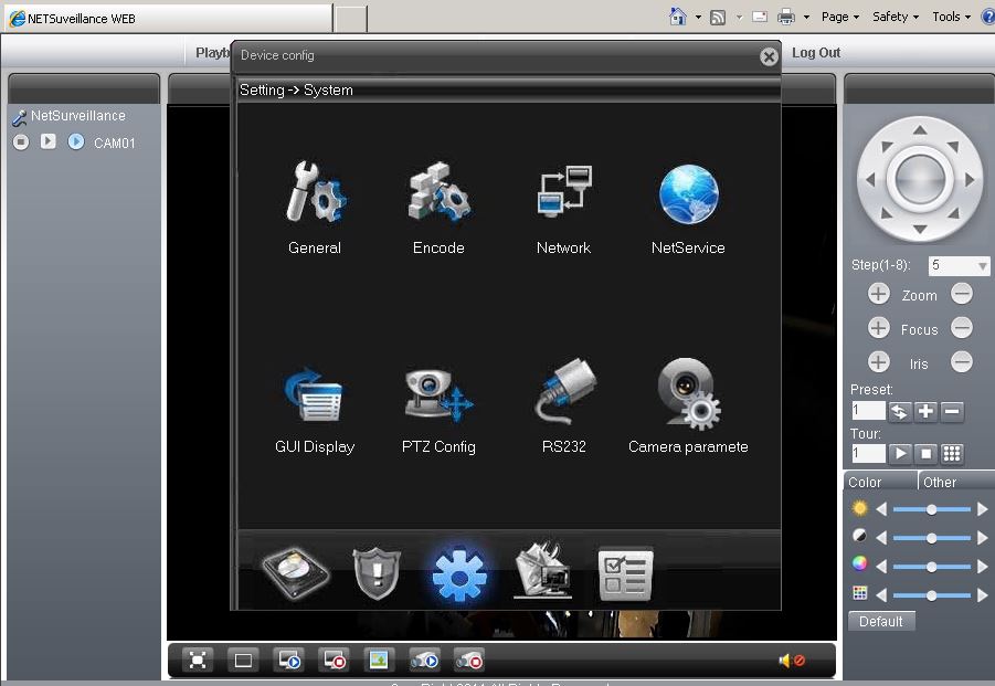

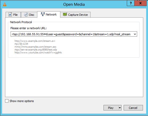

Looks like a clone of some branded camera judging by the GUI.
Camera is currently live at this url.
rtsp://122.60.14.69:5544/user=guest&pas ... eal_stream
Main stream is &stream=0.sdp?real_stream
Can open fine in vlc.
Any help appreciated :)

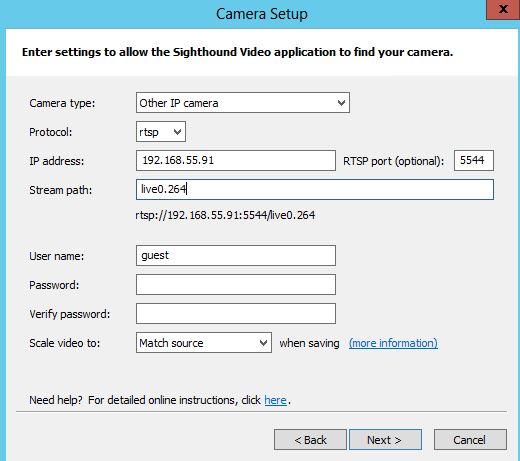

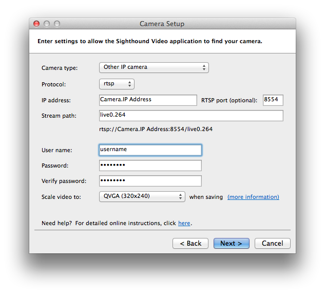

I did a bit of searching and believe the following URL should work with this camera: rtsp://IPADDRESS:8554/live0.264
Protocol: RTSP
Port: 8554
Stream Path: /live0.264
(see attached image)
You should also be able to connect to the URL used in VLC by using:
Protocol: RTSP
Port: 8554
Stream Path: /channel=1&stream=1.sdp?real_stream
As you say, this appears to be a clone and it's fairly difficult to find information on this model. If the above do not work I'll dig a little deeper to find more information.

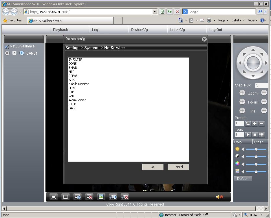

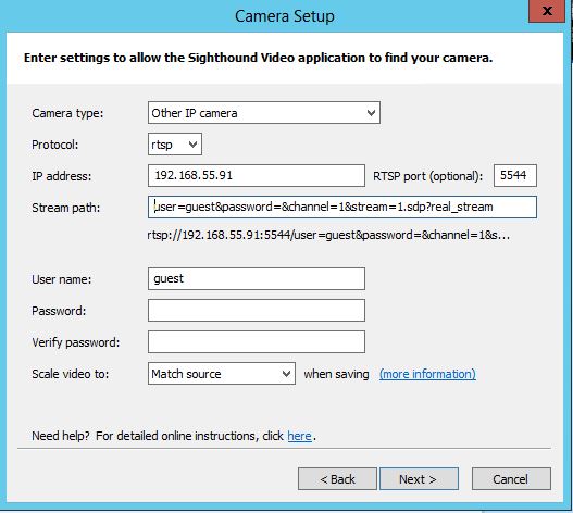

No go :(
See screen shots attached.
Note the camers is accessible from the internet on "122.60.14.69" so you can test any any potential URLs :)
There is also a mobile port exposed on 34599.
I will open that on the router too for testing.
Tested working with this mobile app.
https://play.google.com/store/apps/deta ... MEye&hl=en
Could do a network sniff with wireshark if that might help.

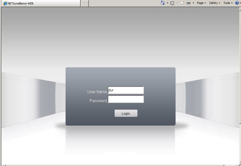

One more screen shot
Looks like this manufacture also uses that same stream address
Love the name lol
http://www.golbong.com/faqs.asp
