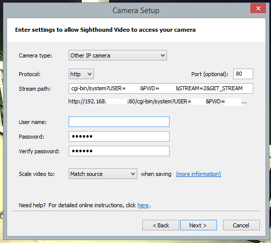

ACTi has a ton of documentation on its web site. But some of it is pretty stale. I still could not find current documentation on the STREAM parameter in this URL, but with a little trial and error, based upon some prior reading, I came up with this. And it works.
For clarity, I've entered full URL's here even though only the path is required in the Sighthound UI:
To use the generic ip camera profile and access stream 1 on my ACTi E73:
http://ip:port/cgi-bin/system?USER=camUser&PWD=camPassword&GET_STREAM
To use the generic ip camera profile and access stream 2 on my ACTi E73:
http://ip:port/cgi-bin/system?USER=camUser&PWD=camPassword&STREAM=2&GET_STREAM
Working through all this also lead me to consider that maybe I could continue to have Sighthound consume the main stream and, when an event occurs, execute a small command line utility of some sort that would use the /encoder path on the camera to grab the snapshot from stream 2. Maybe someday when I've got nothing better to do... :D
In any case, hopefully this discussion will be helpful to other folks with ACTi cameras. Thanks again.
(41.41 KiB) Downloaded 757 times
