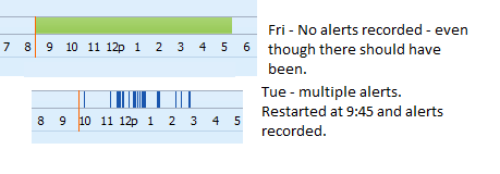

So, I have one rule running for each camera. One is set to any object, during a certain period of the day. It will then copy the file to a network share (which is a onedrive folder) and this will upload to Onedrive. I then would check the videos when I'm at work. They'll often be of the cats entering/leaving the house or family members coming home at lunch or leaving late etc. I first noticed this problem that there would be no videos from either camera. I would typically get 20 - 40 a day. At first, I checked for the usual things like if onedrive is working, network shares working, etc. But they were/are. Eventually, after turning off the cameras and restarting the app, and turning the cameras back on, the alerts would work straight away.
So, the way I'd check if alerts were working, is I'd goto search at the top and select a camera. In the bottom right, I'd see a green bar representing the video cache for the day. I'd expect to see multiple blue/black lines throughout this bar to represent alerts.
It's like it's not reading the events on the video?
I've attached an example from yesterday (Fri) and last tuesday. Even though there's no video cache on Tue, you can see the alerts.
