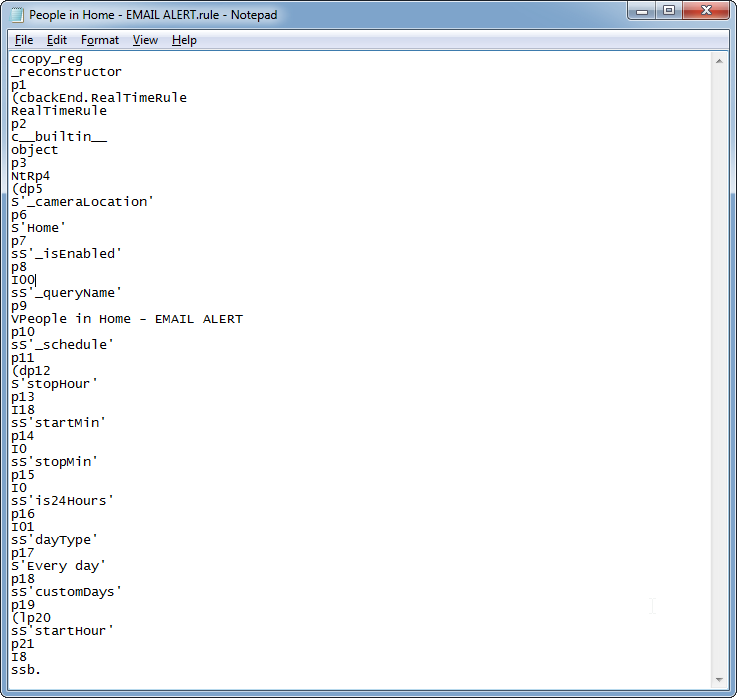

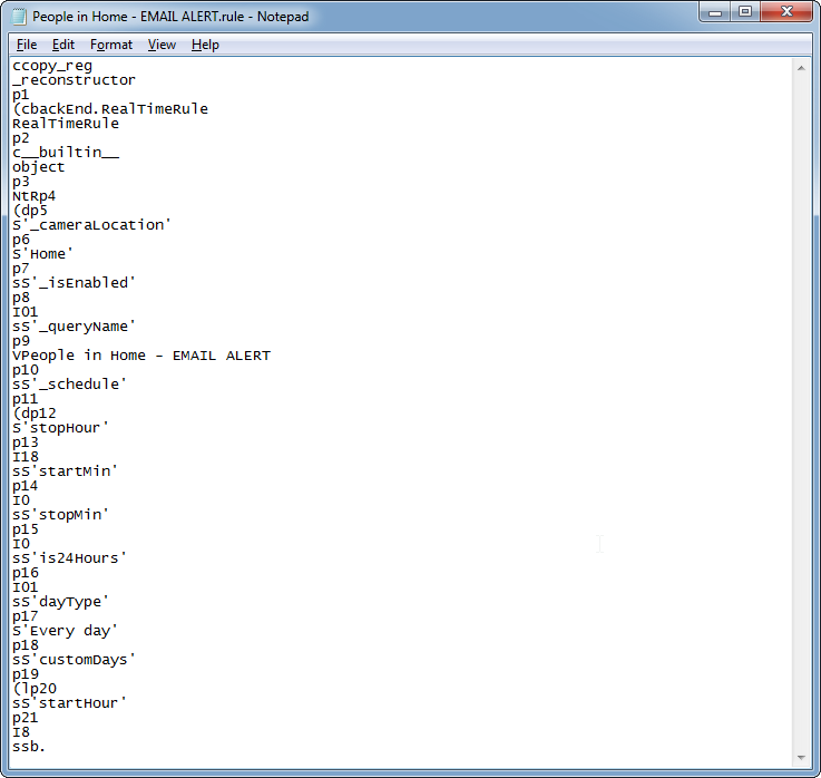

  • Script/piece of code somewhere enables the camera recording rule I have by replacing the *.rule file in the app data folder (windows 7) with another almost identical .rule file that has the checkbox enabled. (Attached two files to this message to see the difference) For anyone curious, you can go there and open those files in notepad. Enable your rule in Sighthound and go look at the file (somewhere around line 17 or 18). There is a "S01" or a "S00" that is always two lines below the line that says "sS'_isEnabled'". S00 = Disabled, S01 = Enabled. Rather than get fancy and writing code to change this line, I just have copies of both files (one with it enabled, one with it disabled) and toggle copying them back and forth on this step.
The rule IS NOT enabled
The rule IS enabled
