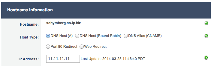

by Devin » Tue Mar 25, 2014 2:56 pm
Also be sure you have "DNS Host (A)" selected instead of "Web Redirect" for "Host Type" on your No-Ip account. I've attached a screen shot of how this should look.
(25.13 KiB) Downloaded 409 times

by mauromoretti » Wed Mar 26, 2014 10:30 am
Thanks, that solved my problem!
